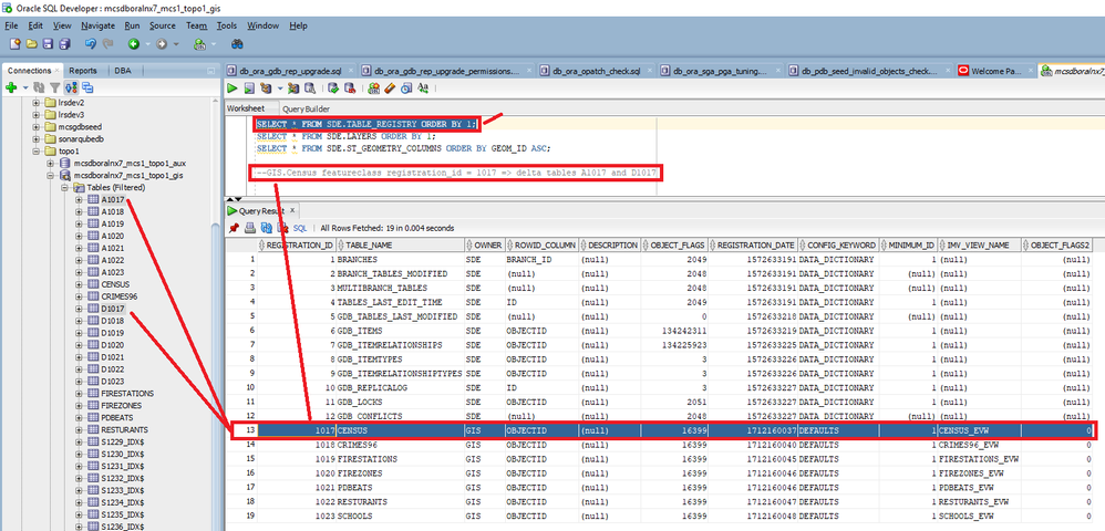

@MarceloMarques @ShannonShields Thank you for the replies. Would there happen to be a table in the geodatabase that shows all of these A & D tables and what feature class they belong to?
MarceloMarques
@JoshBillings - the featureclass registration_id in the sde.table_registry table in the sde repository is used to name the Delta Tables, A<registration_id> Adds Table and D_<registration_id> for Deletes Table.
How to determine the Delta Tables - Adds Table, Deletes Table of a Featureclass or Table registered as traditional versioning.

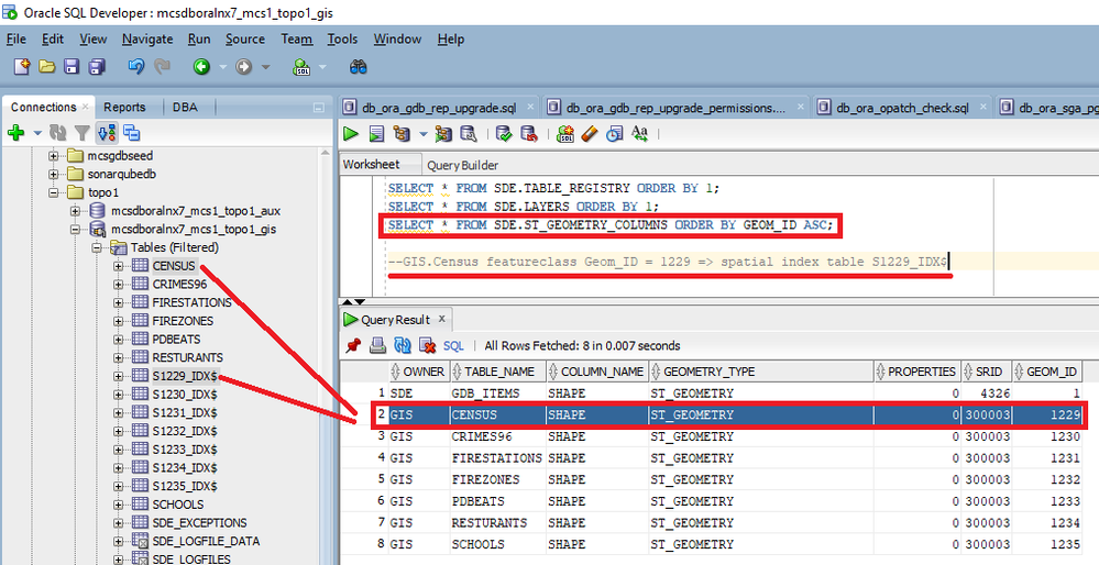

How to determine the Featureclass ST_Geometry Spatial Index Table
