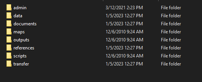

Here is a similar data structure that I use in addition to the folders that ArcPro creates with any new Project.  Glad to see we are all on similar pages.   Would love to hear any input as well.  If anyone has a file structure that works I'd like to see more examples.
