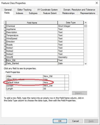

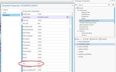

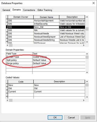

Have you tried managing the templates before publishing?  Just set the template property of the MXCREATIONSTATE attribute to 1 before publishing. This is how I manage something very similar.  I am not sure how it handles edits if they already have a different value, but this could probably be handled in the in the domains of the database and setting the properties of split/merge policy to default.  You will also need to change the default value of feature class' field value too.   Do all this before publishing as well.
https://pro.arcgis.com/en/pro-app/latest/help/editing/create-a-feature-template.htm
  Edit:  Here is an example.  To not confuse you, the Template Properties I did in pro, and the others I used old school ArcCatalog.
