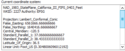

HI,
Can anyone suggest how to resolve on below issue, snapshot attached.. is this possible to fix in the database.
This was in sde environment in the server. we are using oracle SQL developer for the database.
Thanks,
Srinivas

Feature classes in file geodatabases can be more forgiving with corrupt or invalid geometry data than enterprise geodatabases.  I have seen similar issues when some of the geometry data is corrupt or invalid, e.g., are their records that have invalid coordinates for a point?  Have you run Check Geometry on the file geodatabase feature class?  If so, did it find anything?  You could also start by importing chunks of the data in EGDB to isolate which part of the table is causing issues.

The title indicates that you are using ArcMap, but if you have access to Pro you can use the Check Geometry geoprocessing tool that has an ESRI method and an OGC method (drop-down menu).  I have found that the OGC method can find errors that the ESRI method is unable to find.  This technique might help to find errors in your data, if there are any.

there are no coordinates found in the point data and we know the tables which are having issues in sde database but could not get a solution to date, please review what would be the correct solution.
