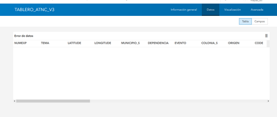

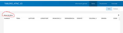

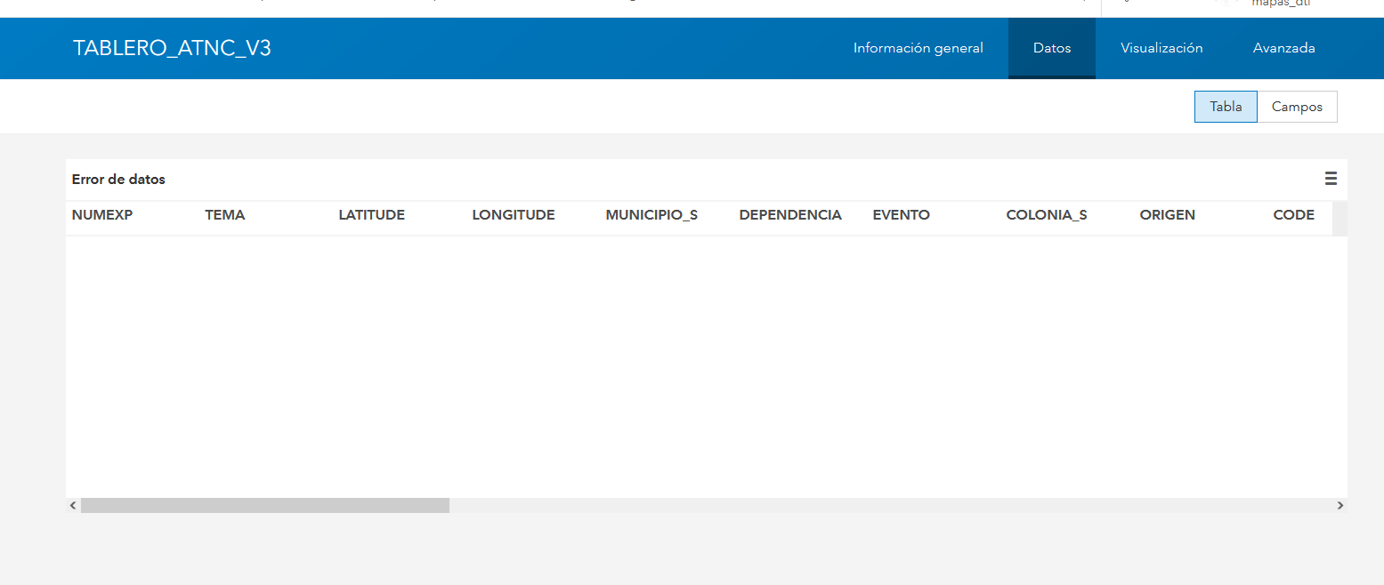

When I connect my DataStore, does the connect with out problem, inclusive when I charge my tables don´t send me errors. But when I try read my data from my table in the portal send me the name from the fields correct but the data send me the label "Data error".
I check the log from my DB and arrive the query correct (select x from y where 1=1).

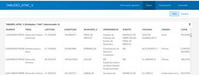

The type data is supported, I was probe copying the same table in my geodatabase and didn't sendme error and the publish was correct.
ej.
Not in my server
in my server
