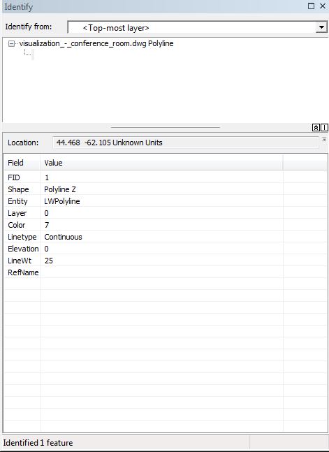

you would need an id to join on. I did a quick test and grabbed a DWG from Autodesk
AutoCAD Sample Files | AutoCAD | Autodesk Knowledge Network

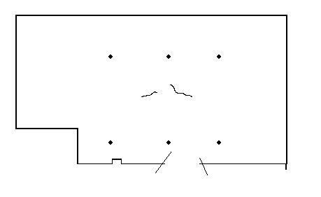

I get this in GIS
the properties are
If you can use refname (on the lights the property is Flourescent Fixture - dont know how to set it in CAD) you wold be good.
Otherwise, you would have to do something crazy like put each segment on its own layer or make it a unique color.
You could convert the CAD to a shapefile and add a field to join on.
