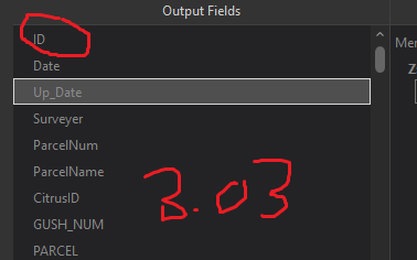

when  appending from layer with aattribute rules to new one  all the fields with editebal  chackbox tiked off
arent mapped with the rest of the fileds
When appending data from a layer with attribute rules to a new layer, any fields with the "editable" checkbox unticked not recognized with the "use the field map to reconcile schema differences option "
the attachments  shows how it was in 3.03 and what heppen in 3.1

OrrGvili
the fields exectly the same except that the source have attribute rules t with the "editable" checkbox unticked
if i delete the rule it work fine
OrrGvili
toady found out it happens when copy paste attributes from layer with attribute rules to layer with no rules
not just with appand
