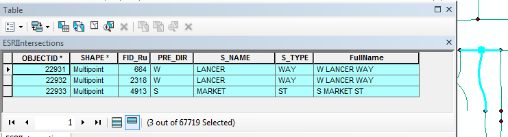

Finally, I would like to merge those true intersections into one point that provides the two different streets:
Notice that there are 3 points at the selected location which is the intersection of Lancer & Market.  I don't care about Lancer and Lancer;  I can create and alternate name of Market & Lancer for Lancer & Market.
