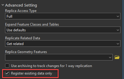

You could perform the following steps:
1.  Sync your replica
2.  Unregister the replica in each geodatabase
3.  Copy the new feature class to the child geodatabase
4.  Recreate the replica using the option Register existing data only
