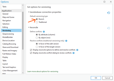

Status changed to: Implemented
In ArcGIS Pro 3.0, the option to set default versioning type has been added:
See Ideas in ArcGIS Pro 3.0  to see this and all of the other ideas you can look forward to when you upgrade.
