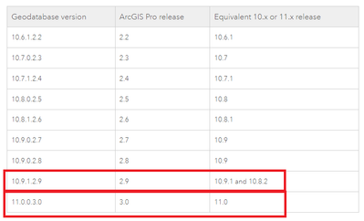

I recently upgraded a version 10.8.1 enterprise SQL Server geodatabase to version 11 using ArcGIS Pro 3.0 Upgrade Geodatabase GP tool.  Doing so, come to find out by design, altered the way the geodatabase items are named.  In v11 it no longer uses the [databasename].[schema].[tablename] format and is now only [schema].[tablename].  This change broke all of my enterprise paths in models and python scripts for things like feature class paths, field mapping paths, etc.  I wasn't expecting that, and it was a big chore to repair.  Please update the documentation to warn of that change when upgrading between geodatabase versions prior to v11.

the Geodatabase Upgrade option is grayed out because you have SQL Server 2012, once you upgrade to SQL Server 2019 the option shall be enabled, but keep in mind that to upgrade the Geodatabase Repository you need 1. take a full backup of the database 2. stop all ArcGIS Server Services 3. disconnect all users connect via ArcMap or ArcGIS Pro 3. add the sde user as db_owner 4. connect as the sde user and perform the geodatabase repo upgrade 5. remove sde user as db_owner 6. take another full database backup.

Yes, it is a minor geodatabase repository upgrade, in your case from 10.9.1.2.9 to 11.1.0.3.1, and you shall have no trouble or just some minimal changes that need to be made.

Enterprise geodatabases in Microsoft SQL Server that you create or upgrade in ArcGIS Pro 3.0
allow you to restore the SQL Server database with a different name from the original name.
Changes associated with this functionality mean that the following is true of 11.x geodatabases in
SQL Server:
ArcGIS Pro 2.2 and earlier versions cannot connect to them.
ArcGIS 10.6.1 and earlier versions cannot connect to them.
Table and feature class names no longer include the database name.
For example, a table named productdata.dataowner.inventory in a 10.9.x geodatabase is named
dataowner.inventory starting with 11.x geodatabases.
