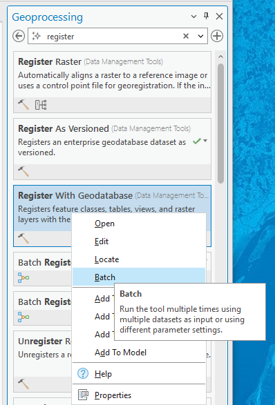

@DannyMac - you can run the "Register with Geodatabase" GP Tool in Batch mode in ArcGIS Pro. This might help you optimize the workflow you mentioned, and the GP Tool can be saved as an arcpy python script for further customization if required. I hope this helps.
DannyMac
@MarceloMarques Understood, but this doesn't register the existing "Database feature classes" that exist in the database when you choose to Register a Geodatabase, and that's what this feature request is about.
