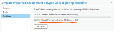

I'd say that what you're looking for can be accomplished using Group Templates: https://pro.arcgis.com/en/pro-app/latest/help/editing/create-a-group-template.htm

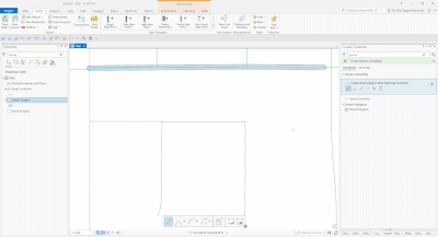

Here I have a street centerline feature class and a street polygon feature class.  I set up a group template so that when I digitize the centerline, a 10 foot buffer is used to create the street polygon at the same time:
