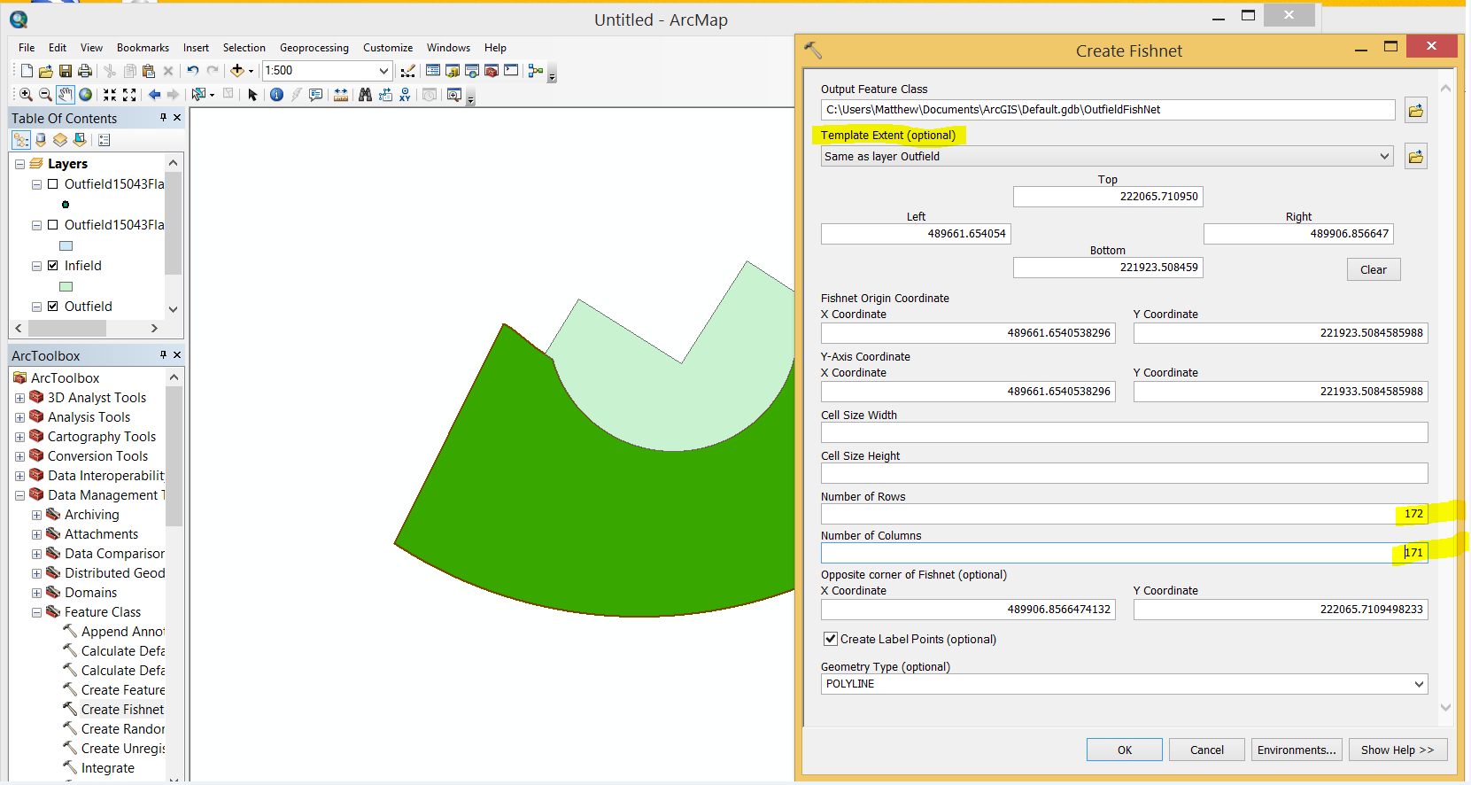

The fishnet command is a tool that currently resides in Data Mgmt Tools>Feature Class>Create Fishnet.  When you run it, it gives you the option to use an extent template, but it uses the feature layer's extent and not feature boundary. CreateFishNet1.PNG
When you run the command, you see that you are basically left to adjust the rows and columns until you get to a point where you are successful in attaining the appropriate number of equally divided areas, over only the outfield (irregularly shaped area). CreateFishNet2.PNG and CreateFishNet3.PNG
I ran this tool eight times before achieving the desired amount of area divisions, but it still wasn't exact.  I would like a tool that would run this process and allow me to select the shape feature to divide and the number of divisions (here 15,000).
Even if I built a tool for this, I do not believe that I will be able to specify the number of divisions desired and will only get so close.
