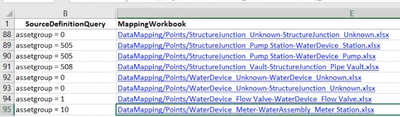

Just one additional question, just to be sure I understand it correctly - one Mapping Worksheet, can´t point to more AssetGroups - am I right? So if the source layer point to more asset group, the best way is to use query definition in Data Reference - as mentioned in the video here:
Duplicate the first initial record in the Excel for each asset type + duplicate the excels each with different name (so it´s not necessary to run the Create Data Loading Workspace once again)
Am I right?
Thank you.
Vladimir
TedHoward2
 - You could use a lookup in a Mapping Workbook for loading data to multiple AssetGroups. Whether you should do that depends on if you need different field mapping per AssetGroup etc.
- Yes you could do that. I would suggest consolidating where possible though. There's nothing wrong with using the following sql:
assetgroup in (1,2,3)
