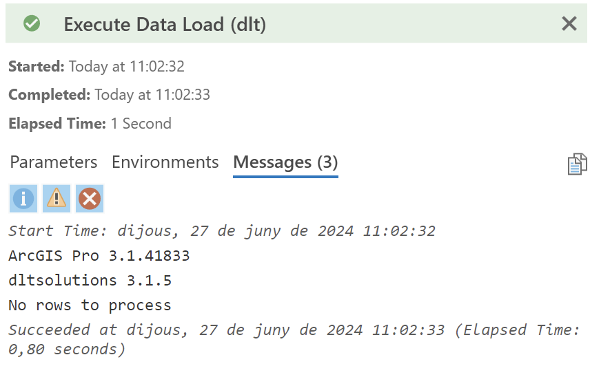

Hello, everyone!
I've been following the Load data into the ArcGIS utility network tutorial and after some days, I've encountered this issue that doesn't allow me to complete the final step.
The Execute Data Load tool does not fail but finishes very quickly displaying the message "No rows to process"
I have already upgraded the ArcGIS Pro to the 3.1 version used in the tutorial, I've checked the Excel worksheets to make sure all data sources are correct, but no matter what I do I still get the same result.
Has anyone seen this behavior before?

EApolinar
Thank you, @shamenw and @MikeMillerGIS for your quick answers.
After further revision of the Blank and Complete mapping DataReference workbooks I noticed that I needed to leave the Enabled columns as "VERDADERO" in Spanish, instead of "True", since this is the language I was following the tutorial in.
It is weird since all data is actually in English and so are the drop-down options for data validation in the DataReference workbook:
Everything is working now as expected, Thank you!
