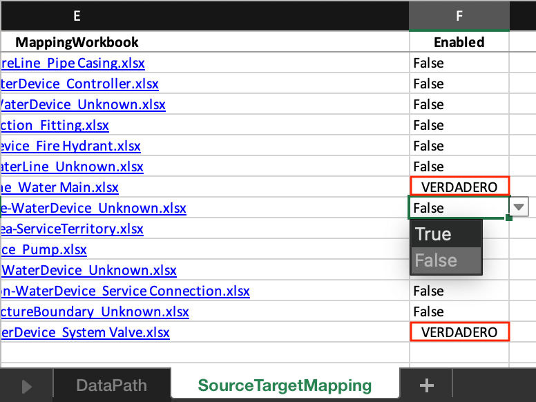

Thank you, @shamenw and @MikeMillerGIS for your quick answers.
After further revision of the Blank and Complete mapping DataReference workbooks I noticed that I needed to leave the Enabled columns as "VERDADERO" in Spanish, instead of "True", since this is the language I was following the tutorial in.
It is weird since all data is actually in English and so are the drop-down options for data validation in the DataReference workbook:
Everything is working now as expected, Thank you!
