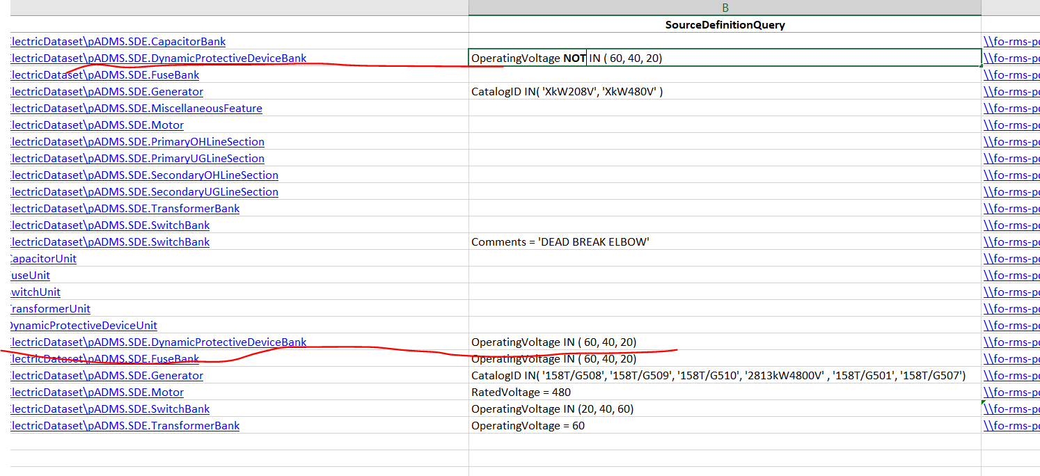

2. Say, for example, we need to separate our dynamic protective devices between medium and low voltage to map them to separate asset groups in electric devices, we can do that in the data_reference workbook by setting a definition query. BUT do we need to set opposite definition queries to ensure that data is not mapped incorrectly. Something like below. The first row is taking medium voltage devices and the bottom row is pulling in low voltage devices.
This same concept would apply in any situation where one needs to pull out and distinguish asset groups?

For your second question (2) – Based on your description and screenshot, your workflow for separating values using the inverse query looks correct. Is there something more specific you are trying to achieve here?
