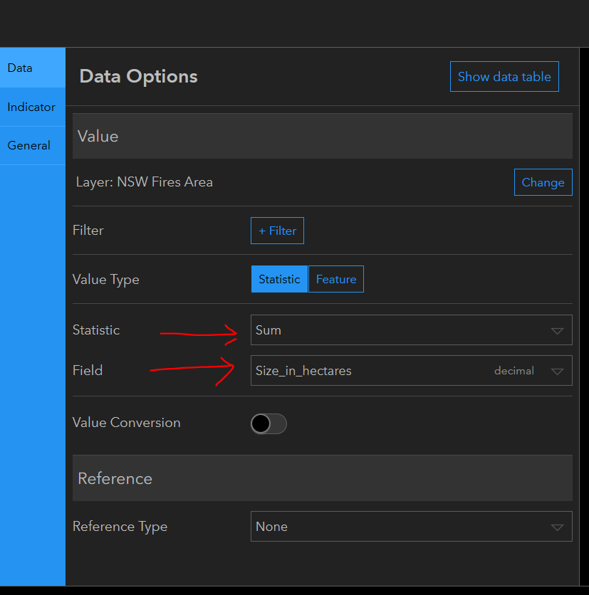

So if I'm understanding right your users are adding new cases using survey123 and you want to sum those on a dashboard to show the total number of cases?
This is very doable and you will need to have an indicator widget added and then you can set the statistic to Sum and the Field to the field you want to add up!
Happy to discuss more if needed!

Hey David Kunz‌,
