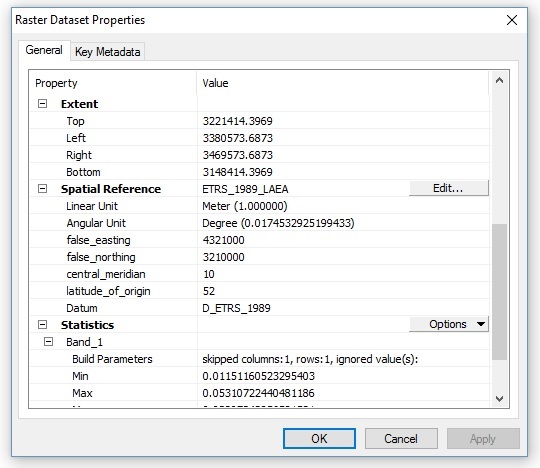

OSGB data is here:
I've already succesfully used the OSGB to ETRS_1989 transformation on this data:Untitled_2.jpg

Then I still think you have messed up the coordinate system of the Lambert data.
I think it should look like this :
Note, this is the same parameters as your original, but the GCS is specified as WGS84
