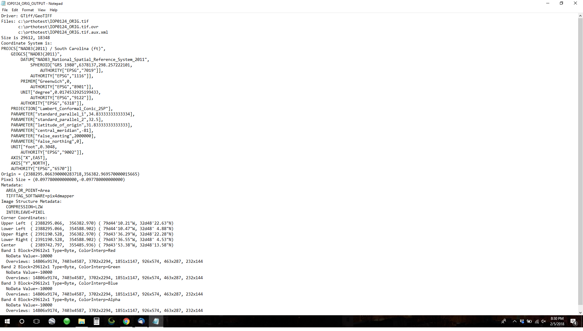

So upon further review....Even a properly defined header directly from Pix4D is importing incorrectly.  It is still incorrectly bringing it in with latitude of origin of 31.5 instead of the 31.83333333.  This is mind boggling to us as it is properly defined in the header.  What is Arc seeing that is not in plain sight?
Here is the header as read with gdalinfo:
pix4d header
