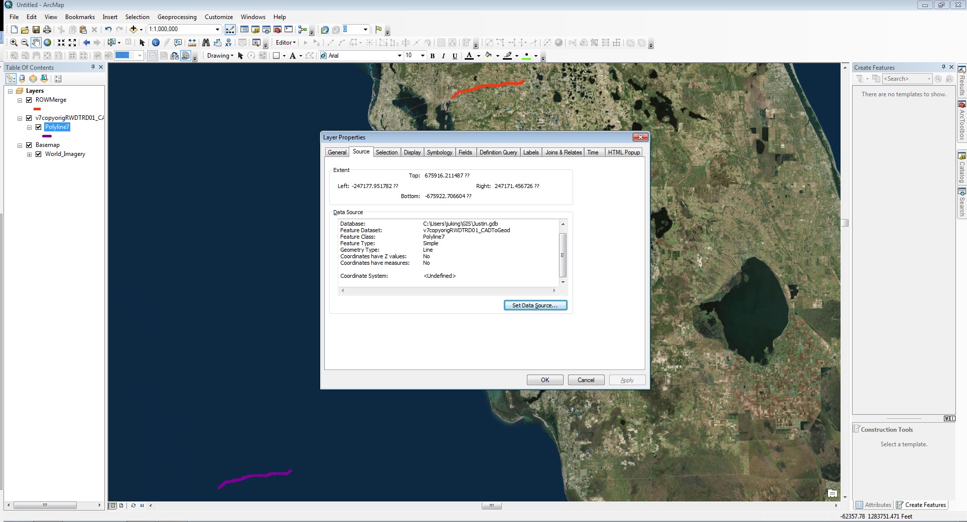

I've read some past posts on this but I still can't fix the problem I am having. The worst part is that I have successfully moved this exact file into the correct location from Microstation to ArcMap many months ago, but now am having trouble recreating that.
Starting in Microstation, the file has no geographic location data. I then use the CAD to Geodatabase tool to bring the DGN file into ArcMap. In the field "Spatial Reference (Optional)" on the CAD to Geodatabase tool window, should I enter in my desired output Coordinate System or bring it in without one?
The picture attached "Input" shows how the the correct shapefile and the shapefile I am trying to bring into ArcMap to match it are in different locations, but have the same coordinate systems.
If further information is needed to answer this question please let me know.

Hi Justin, if, indeed the DGN data has no geographic location data, as you say, then it should be bought in without a spatial reference and georectified by hand. I suspect though, that your data does have some kind of location data applied to it, as it appears to be projecting, at least at the right size, if not the correct location. Assuming that your last picture, "coords", is the coordinates of the DGN, I don't recognize an obvious coordinate system. Try importing the original data into an empty map, and leave the spatial reference blank. If you examine the properties, source tab, what extent is shown there? A screenshot of this can often help people take a better guess at what coordinate system the data was created in.
JustinKing
Deactivated User
Hi Sephe, here is a screenshot of the feature extent for the file I am trying to bring into ArcMap.FeatureExtent.jpg
