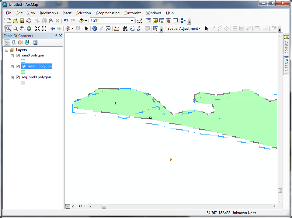

Anyway, the other two coverages are definitely converted from rasters. Here's a close-up:
Also complicating the issue is that these two files don't share the same country boundary. There could be a datum difference between them, but the offsets are not regular, so it's hard to say for certain.
