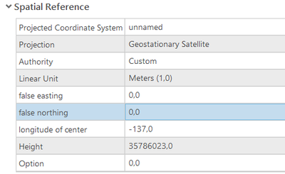

Just reading this NC to ArcGIS Pro provide a description for the reference via the layer properties - is this usable?
I used the info in the screenshot above to define my map projection. Never used the projection must be said.
Result (partly transparency on the raster)
