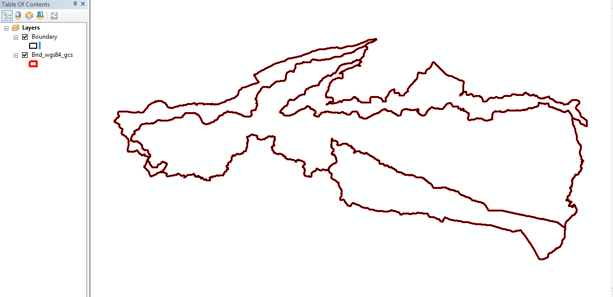

JayantaPoddar
MVP Alum
Even reprojection to GCS_WGS_1984 is done successfully. And I don't see any mismatch between the two data.
