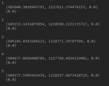

You should get something like the following:
(I ran this on a test dataset that doesn't have any elevation values populated, so the 0.0 is expected, in my case).
The first row is the actual X, Y, Z of a point in your feature class.  If it's a line or polygon, it'll be the first vertex.
The second row is the Z value in your elevation attribute field.
If that last value on row 1 doesn't match the number that's by itself, then that's your problem.  ArcGIS can only project things based on those hidden back-end coordinates.  Anything in the attribute table is just for show.

At this moment, we are not populating our features' z-values with data. While our dataset has z-values enabled, the z-values are populated with the default 0 values, as you show in your screenshot. We are gearing up to incorporate z-values into our systematic data maintenance, and I have created a python notebook designed to populate our existing features with z-values for each vertex based on the elevation data we've been storing in the attribute table.
