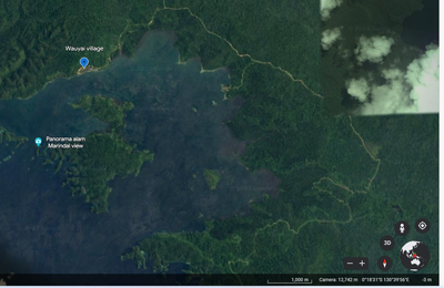

I am looking for a village in Indonesia.  The coordinates given are S 0 deg, 18'; E 130 deg, 40'.  On gEarth, it shows a village in that location.
In Pro 2.9, that position is in a different place and there is no village according to the imagery basemap.  Can anyone help me understand why the coordinates don't match?

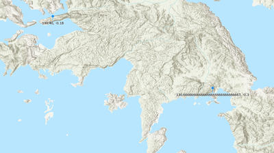

Your difference in location is caused by using degrees-minutes-seconds format as they would be decimal degrees.
0 deg 18' S is not -0.18 deg, but -0.3 deg; and
130 deg 40' E is not 130.40 deg, but 130.66666667 deg.
If I use correct decimal degrees in ArcGIS Pro, the point appears on the same location as on Google Earth.
