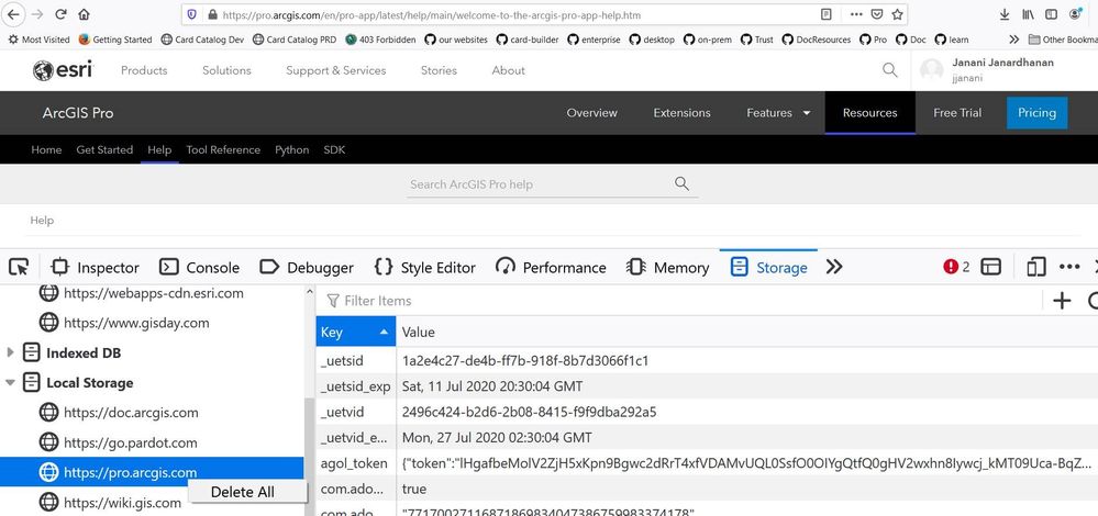

Thanks for retesting. Further information from our teams:
Can you clear local storage as seen in the screenshot below? This is in Firefox.
Also, could you sign out of esri.com/arcgis.com and then retry signing back in after clearing cookies and local storage (just once), you should be set up for using the arcgis.com sites without having to do this again.
Let us know if this works.
