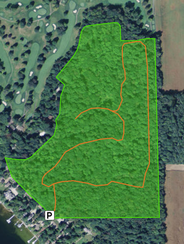

I have a webmap on AGO, creating a simple virtual hike of a nature preserve.  http://arcg.is/1W9z5NH
I've made several attempts at creating a Story Map Tour from this webmap, but I keep losing the tour points that I've set up in the webmap.

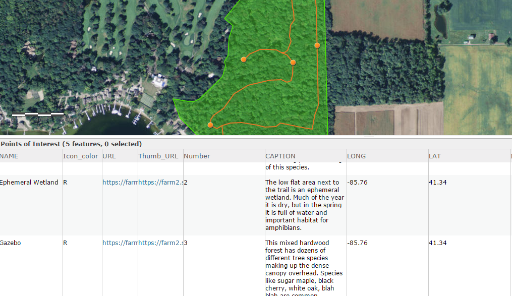

For the tour points in the webmap, I created a feature service, called "Points of Interest", using the story map tour feature class template on GitHub ( map-tour-storytelling-template-js/samples/feature_class at master · Esri/map-tour-storytelling-templ...​ )  Name, caption, photo urls, colors, lat/long, is all complete for all the tour points.

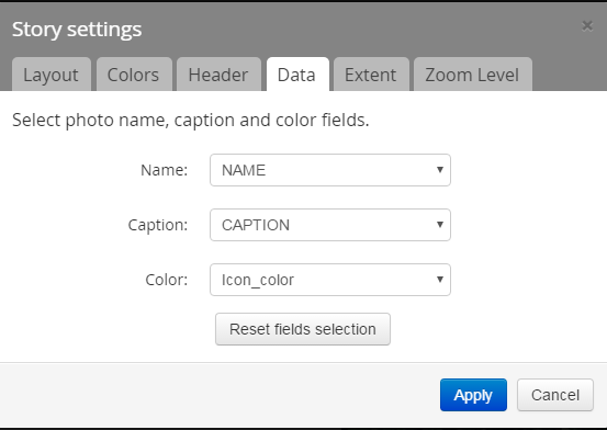

The Points of Interest layer seems to be correct in the Map Tour settings
but doesn't display any of the points or photos that have been entered in the attribute table on the used in the webmap.

Changing the fields seemed to make it more confused--it seemed to want "Caption" rather than "Description".
Is there a character limit for text fields for the caption/description? I'd used a file geodatabase/feature class for creating this specifically to have more than 254 characters for the caption field. However, I just did a quick test....exporting my FC as a shapefile and using that data layer instead in my webmap for tour points layer. That seemed to solve the  "where are my points" problem when it imported into the storymap.
