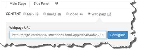

  • I have two organisation accounts.  (A & B)
  • I want to share a Map Journal created by A, with B.
  • The Map Journal also contains 3 story maps (swipe, 2x time) that have been embedded via a URL.  These story maps also created and owned by organisation A.
I have shared ALL of the content (layers, web-maps, apps) created by A, to a group owned by B.
When someone from B (who created the group) tried to open the Map Journal.  The maps that are a part of Map Journal (ones that include main stage actions) display fine for A & B.

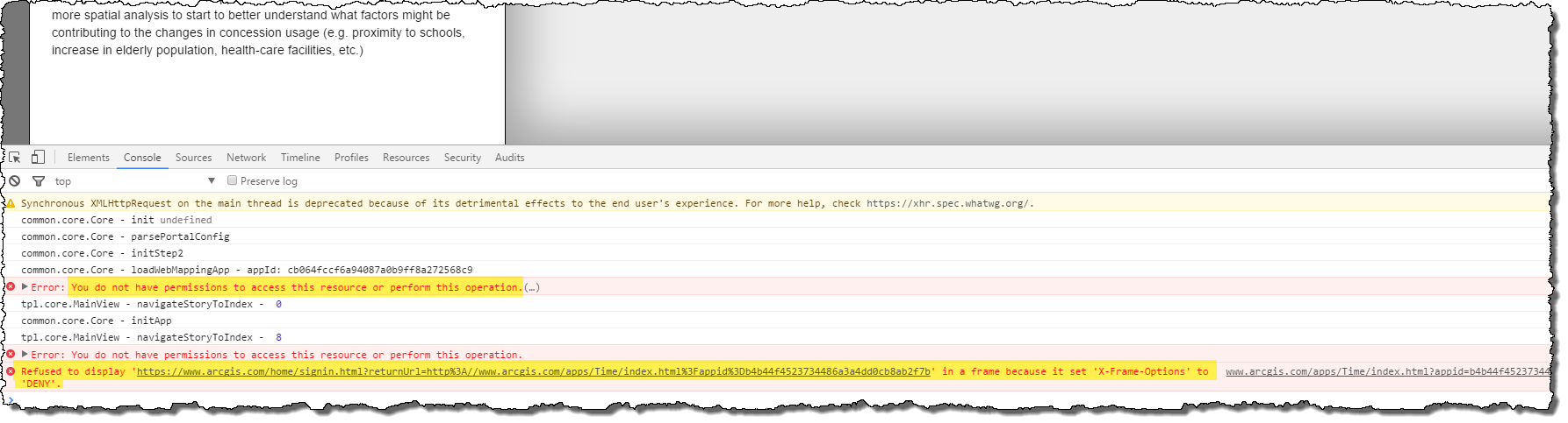

When someone from B (who created the group) tries to access the sections that include the embedded story maps,the page denies the request:
If the same person tries to view the separte story map in an new tab, they have to login to B again, but then works fine to view the story map from A.

Thanks for reporting the issue. We are currently discussing how to fix this, there is a related issue (from a technical point of view) open in the support system for this: BUG-000092958. I will try to keep you posted here as we move on that. From now unfortunately I don't know of any simple workaround. I think your only solution as you suggested is to download and host all the apps.
My diagnosis is that, as the application is embedded in a frame it can't reuse the user identity that has already been acquired in the main storymaps so the application that is embedded will attempt to redirect itself to the sign-in dialog to acquire identity, this process cannot be completed as the sign-in dialog does not allow that sign-in in a frame. We are discussing where a modification should happen, either in apps or sign-in dialog to make that use case works.
