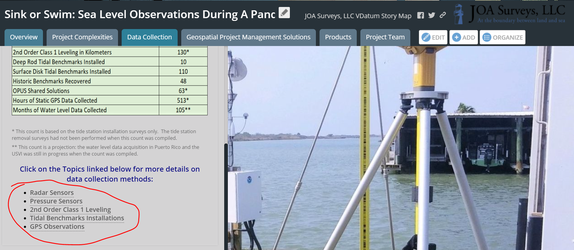

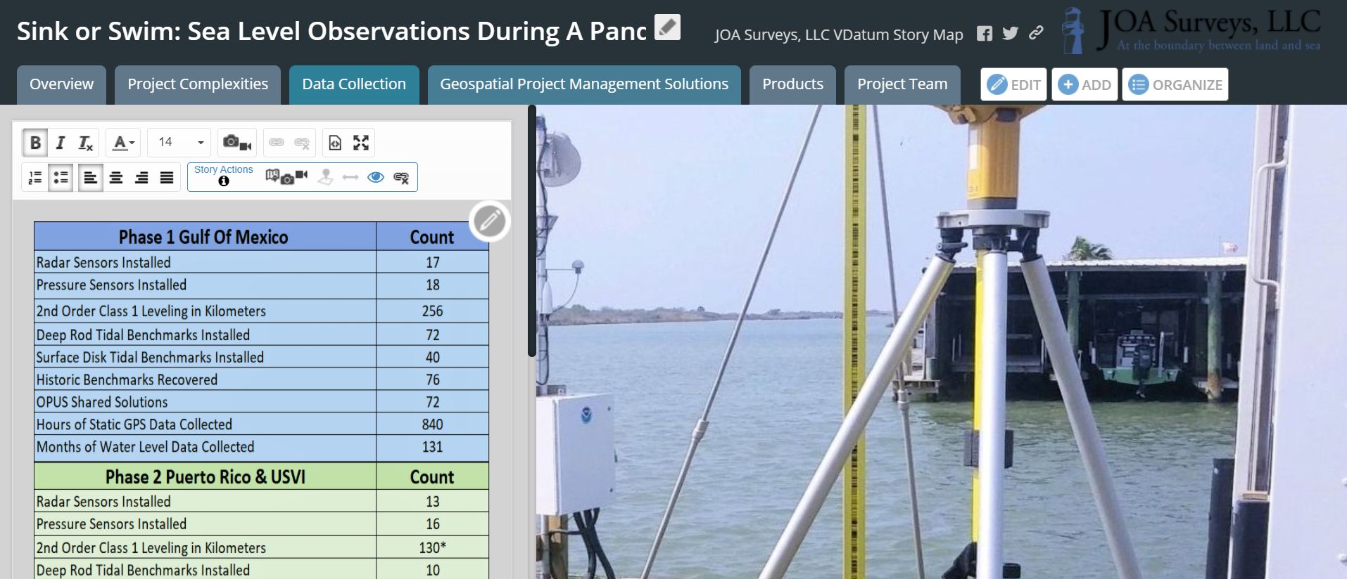

However, I find that with the static images I choose the images will not appropriately size across viewer types. On a lap top this story maps images look fairly good. On a TV screen they are not scaling to fit the screen.
Example: Photo is cut off in TV frame.

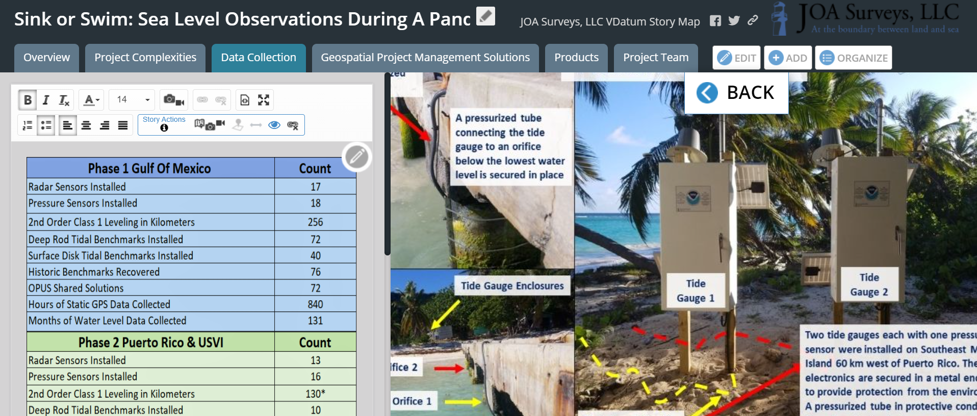

The pop out tabs on this tab of the story are also not fitting the frame:
On a cell phone this story mainly fits the frame but pop out tabs will not automictically rotate or fit the frame. When I began this story map I contacted many ESRI specialist and they were very helpful. The reason the images look good on a laptop now is because the agents and I worked through resizing issues of generally around 825X500 with mid resolution for pictures. I am looking for constructive criticism on a way to get all my photos to fit any screen across any viewing device. The agents I spoke with told me that this was a limitation to using images in the classic story map version. Again on a lap top it looks great- on a phone it also mainly works (except for the pop out tabs). On a television it is not working well. All advice is appreciated.
