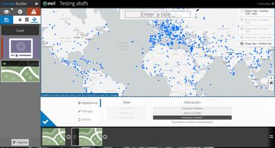

@BriannaForcier1 -- You need to click the pencil in the lower left corner of the map and have the Appearance tab active if you want to make changes to the map's extent that are saved to the story. If you don't see the blue dashed line around the map (see screenshot, below), then any extent change you make to it isn't saved. Also note that Cascade doesn't have autosave, so you'll need to click Save for any changes to persist.

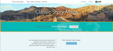

Hi @BriannaForcier1 -- Thank you for your helpful additional feedback about the classic website!
There is a banner at the top of all the pages that is meant to direct people to the new ArcGIS StoryMaps website that has more information, but we are planning additional changes to the classic site in a few months, so we will consider your suggestions as we make the next round of updates.
