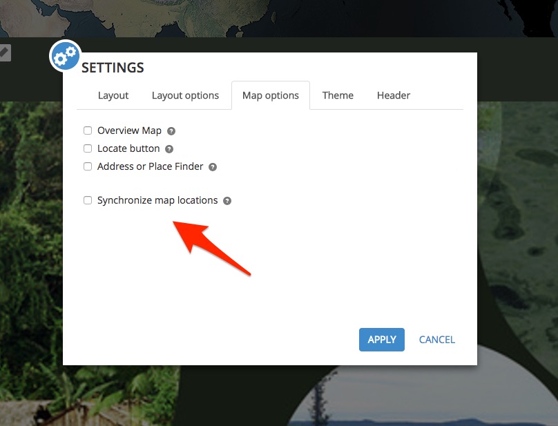

When using Map Series, the home location is set by the initial extent of the webmap (the extent that was saved from the ArcGIS Online map editor. If you panned your map and saved again in the editor, the Map Series app would use that extent as the home extent. Another possibility if you are using multiple maps, you may have checked the "synchronize map locations" option, in which case, the home extent uses the extent of the first map for all the maps.

Yes, editing the layer popups in the web map is the "map editor" I was referring to. When you click "save" in the editor, it will save the current extent of the map as the home extent in the app. The map series app will just center the map. To offset it for the description, just move offset it in the map editor and save it again.
To your last question about clicking on a point to change the tab, it is not possible in the hosted version of the app. If you are willing to download the app and add a little bit of JavaScript, you can get it to work. Here's an example The World is Full of Circles | Travel | Smithsonian (Look at the last "map" tab).
