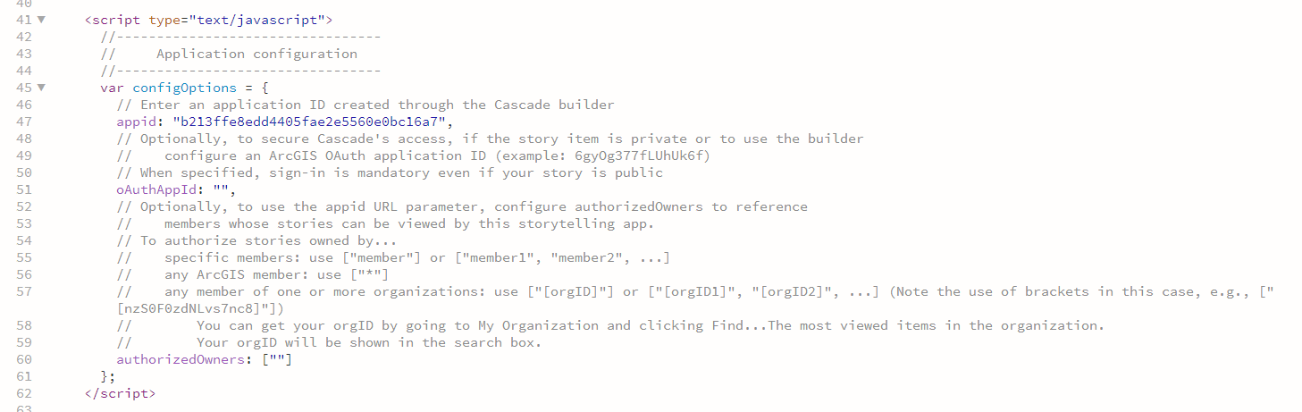

You'll need to add a registered app item for your hosted Cascade app code on your portal, then paste the OAuthAppId for that item into line 51. Follow the Register your app section here to get the ID: Add items—Portal for ArcGIS (10.7 and 10.7.1) | ArcGIS Enterprise

Which file should I add from my computer? The zip file from Storymap doesn't work.
