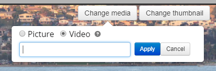

What happens if you try and add a video manually?:

Videos are hosted on AZGFD's Youtube Channel. I add the link to the CSV, the data propogates appropriately, and when I open the webmap upon which the Map Tour is based in AGOL, I can click on a point, then on the "More Info" link in the callout, which opens and plays the video in You Tube.  BUT, when I open the Map Tour and navigate to that "page" in the tour, the main image box appears blank. I don't seem to be able to find any Change media or Change thumbnail links on my builder page that allows me to change the media. On the bottom of the configuration page that opens in both builder and in AGOL when I pick "configure this app" I have a box that says:  Editing data is disabled on this CSV data source.  But I can still edit it in the basemap AND in the csv in google sheets.
