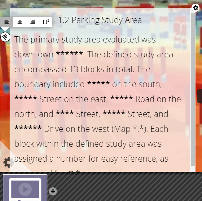

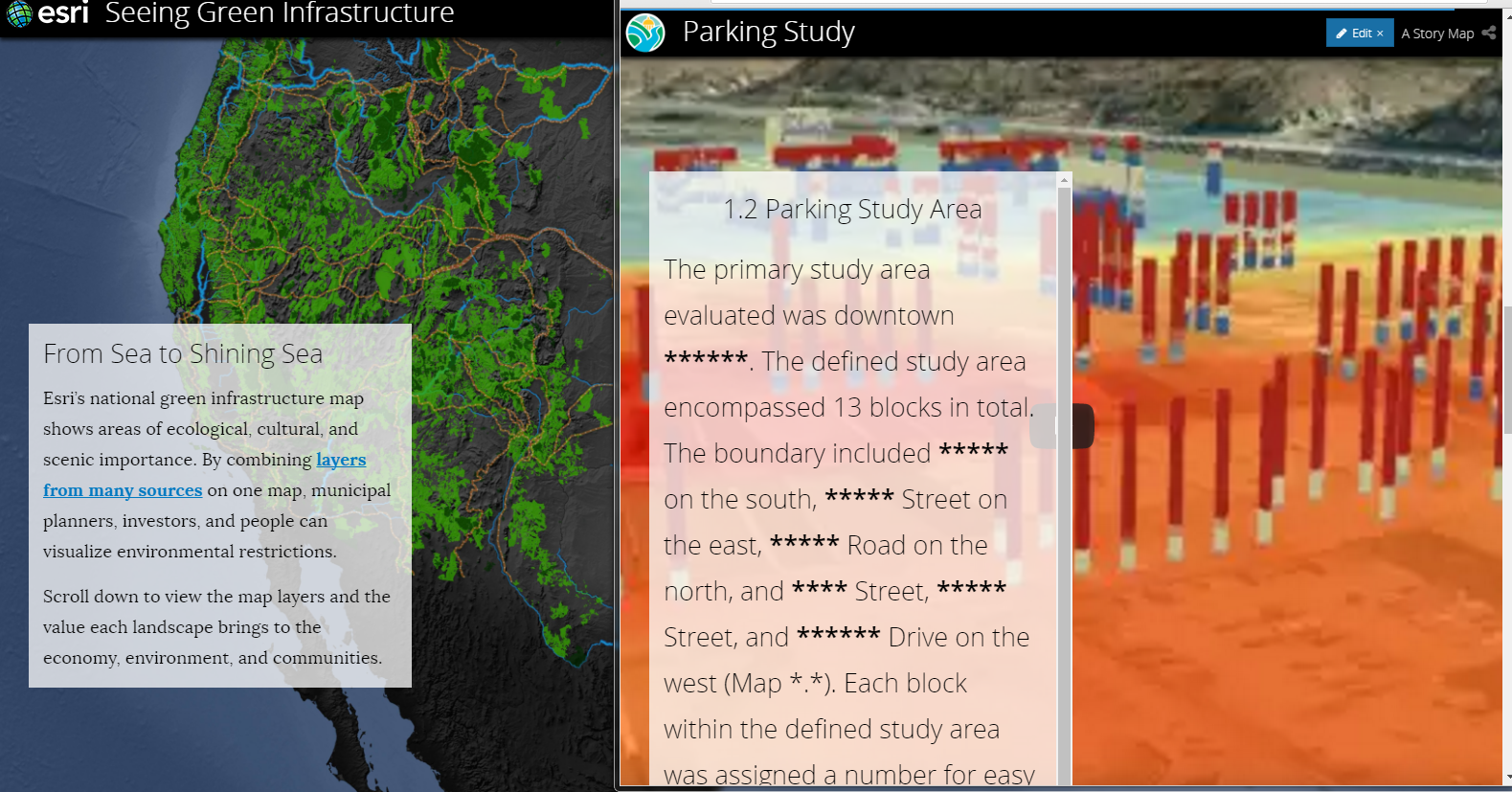

Owen, I am unable to change font size in the immersive section.  It is giving me large text and I do not know how to reduce size because the toggle option is size is not working like you say; but the alignment options do.  You can see the comparison below.  You can tell that mine is on the left and formatting of text is hideous.  I also added what it looks like in the edit session too.Capture.PNGCapture2.PNG

Hi Adam,
Sorry you are having an issue with your story. Something may have gone wrong with that panel. If you are able to share the story publicly and send me the URL, we can take a look and try to see what happened.
Did you possibly paste in text from somewhere else? If so, can you let me know what source you were copying from?
I'd recommend deleting all the text from that panel and starting again. If that doesn't work I would create a new view.

AdamCottrell
Yes, something did go wrong with the panel.  I do not know but I deleted it and created a new one and the new one is resizing as expected. Thank you!
