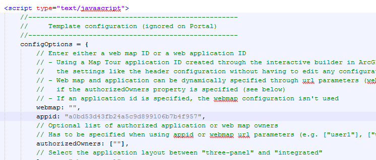

The same error, (web map or application identifier not specified.) My assumption is, you copy and paste the appid into the index.html file, customize or configure what you need, and I use the same link to view my updates (http://icpre.maps.arcgis.com/apps/MapTour/?appid=a0bd53d43fb24a5c9d899106b7b4f957) or does it automatically update the app stored in ‘My Content’ folder on my Arcgisonline account?
So it means that your deployment is not correct. maybe delete your folder and try again?
Does it work when you use the appid i previously gave you?
No the customization of the template that you will do on your computer won't be reflected in the hosted version.
You should only use the downloadable for advanced configuration like if you change the header background or replace the arrows icons. The online version provide some possibility of customization through the settings dialog and we don't recommend you  use the downloadable version if you are not comfortable with deploying the application on a webserver. We will continue to add more customization in the hosted version, you will benefits from those features as they are deployed in the next months.
