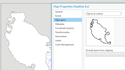

AlfredBaldenweck
MVP Regular Contributor
The trick is to clip the map to whatever features you're using.
For some reason the map frame will assume you want white, even if you set that map's background color to something else.
