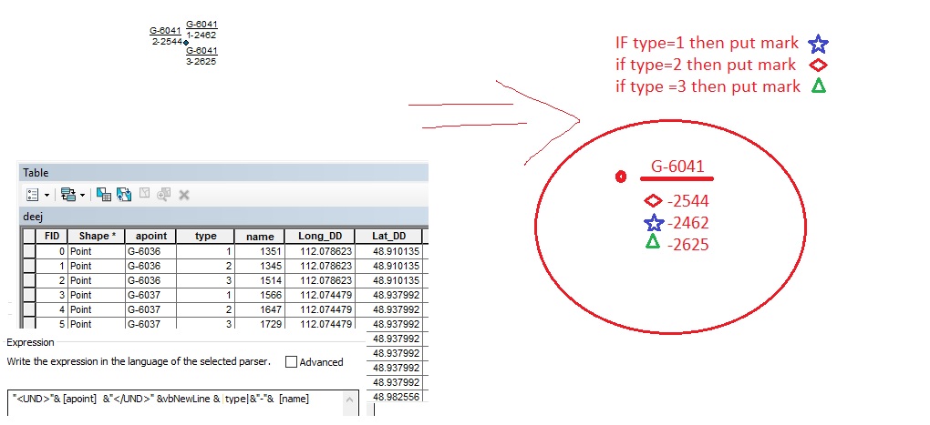

hello guys
I have a problem. I have a shp file with 8300 point information.
1. How does one value be displayed across multiple points?
2. Is there a different type of label on the label?
I'm trying to show pictures. Give me some time to help, please

Dear Richard
I've seen your blog, it's so amazing. I am glad for your help.
i used your label expression it is work. but it is not my searching result. Please, tell me
1. how i use "IF",
example:
Function FindLabel ( [type] )
if findlabel=1 then "<FNT name='Esri ERS Operations S1' size='12'>1</FNT>"
else
findlabel=2 then <FNT name='Esri Cartography' size='12'><CLR blue='255'>Ê </CLR></FNT>" ...
2. how puting other label [name] after those character? it is not similar [street_name]

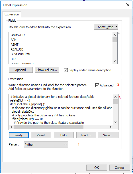

Try the code below in an advanced label expression by doing the following.  1. Change the parser to Python at the bottom of the label dialog.  2. Check the Advanced option checkbox.  3.  Remove any code you see in the expression dialog box and paste the code below in this post into the expression text box and modify the path in line 9 of the code below (relateFC = r"C:\your_path\deej") from "C:\your_path\deej" to your actual deej feature class path.
You have to change the path in line 9 to be the actual path to your deej point feature class, otherwise the code won't work.. If you have any problems please post the error message you get.

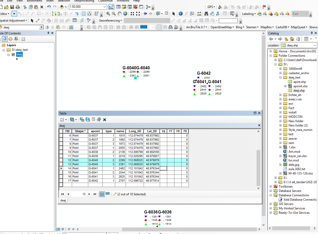

I found my mistake. your program is running. I'm sorry for creating a problem. I sent you the picture.
I have another question.
labels are duplicated when multiple points overlap.
Is the apoint value the same as one label?
Thank you very much for your patience
RichardFairhurst
MVP Alum
I guess for points there is not an option to remove duplicate labels, and duplicates are produced by the code I gave you.  I have modified the code to output a blank label if the apoint value has already created a label, so no duplicate labels will be created.    You need to still modify line 11 for the path to your deej feature class (the code changed so it is line 10 and not line 9 that needs to change).
Duplicate labels will be eliminated whether or not the points actually overlap.  If you have some points that have the same apoint value but don't overlap and you want a label for each point when they don't overlap, then the code would have to examine the point geometry to only eliminate labels when the points actually overlap.  I did not make the code do that.  In order to even attempt to add subroutines for that I would need to know more about the scale of your map to determine how far apart the points have to be from each other before creating another label.  That is complexity that I won't tackle, since I don't want to devote the time it would take to make code that will work for any random scale you may want to print.  Someone else would have to contribute to this thread with ideas on how to tackle that if you want the labels to behave that way.
