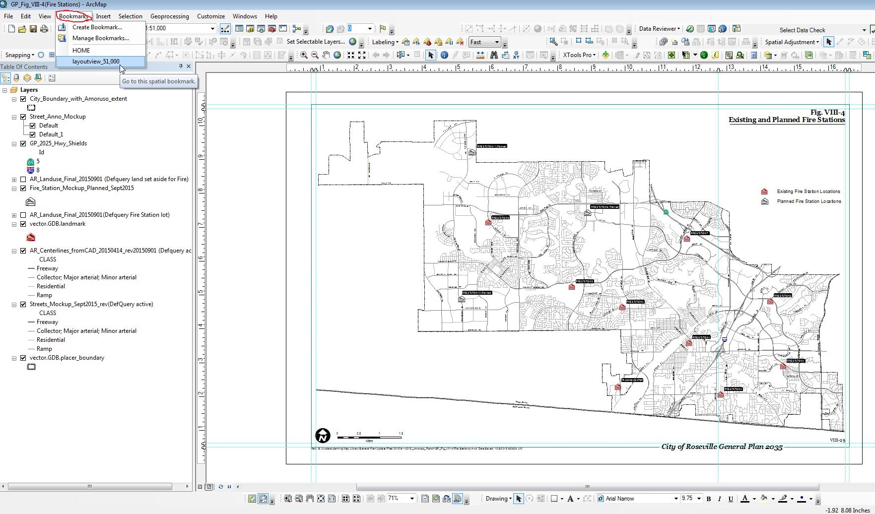

To add some detail to the suggestion by Kyle Balke
Bookmark places—ArcGIS Online Help | ArcGIS
An example:
By setting a spatial bookmark, you can always return to this spatial extent after working on an mxd.  For example, for this figure I added a bookmark called "layoutview_51,000" so I could remember what to reset the figure to after making edits.
