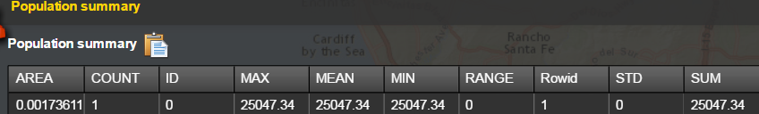

Thanks Dan & Robert, It is just to make the table looks good and they also indicated that other users might know what OBJECT ID is. The geoprocessing widget in Flex produces  the record set as its final product so there is no way I can modify it. I have been using AppBuilder in the past but my current organization uses flex builder because it is easier for them to host all the services in ArcGIS Server without requiring ArcGIS online or Portal for ArcGIS subscription. I also realized the output fields from the resulting table are arranged in alphabetical order which is not what I wanted like the example below. Any ideas?

Just an FYI, it looks like you AREA field is in square degrees... that may be more of an issue to explain than the id field name

Sorry, this is just an example I got from ESRI (ArcGIS Viewer for Flex). It shows the added ID field and how the fields are arranged alphabetically.
