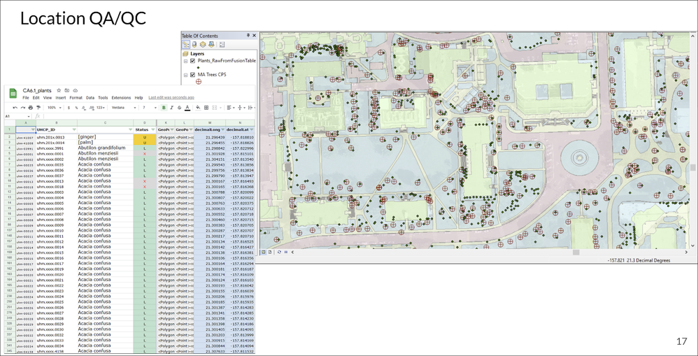

Before we could do anything with the data, we had to first clean up the location accuracy of plants as well as its attribution. The XY coordinates were originally mapped by using aerial imagery, which introduced displacement errors. Fortunately, the University had just completed a new Campus Topographic Map project which included accurate locations of major trees. We used this new CAD topo locations as the target of where to move the initial data load.
Correcting the initial data load location to accurate survey coordinates

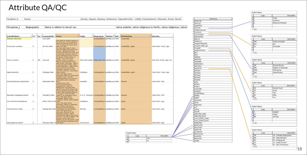

Also by this time Noweo Kai, the new Campus Arboretum curator, was hired by BGM and assisted in data cleanup. Since she also came into the job having to decipher the old data, we tried our best in assisting her by creating domains in the geodatabase- mirroring her predecessor’s spreadsheet look-up values as best as we could. Having her enter values from drop-downs instead of free-form data entry not only sped data cleanup but also helped us avoid introducing new typos.
Attribution QA/QC and assigning domain values

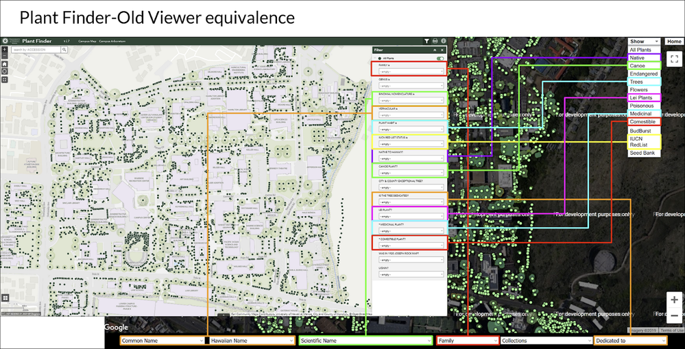

After the initial ETL was completed, our first goal was to replicate the original BGM Plant Viewer’s purpose and functionality in an Esri GIS environment- thus producing our current Plant Finder. It is a publicly accessible viewer created from ArcGIS Web AppBuilder that allowed users to find and filter plants based on their family, scientific name, common name, habit, & IUCN red list status, as well as whether the the plants were native, introduced to the islands by ancient Hawaiians, dedicated to a specific person, medicinal, or comestible… information that were all available in the legacy viewer. Improvements we made with the new viewer allows the ability to filter by genus, whether the plants have significant lignin, and if they are part of the City & County Exceptional Trees program.
Equivalence comparison between original and new plant viewers

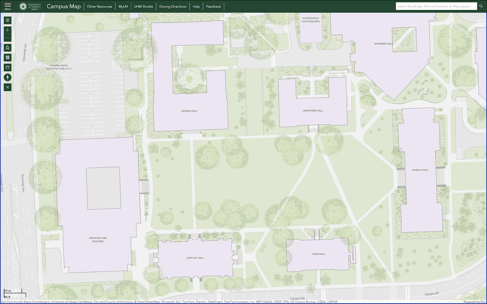

Plant information (specifically the “Canopy Area” field) was also used to design our custom campus basemap, which includes tree canopy symbology that are relatively accurate in size to the surrounding environment. In Hawai`i, we commonly describe surroundings when arranging a meeting place or giving directions, such as saying “meet me by the big banyan tree” or “turn right on the sidewalk after the giant monkeypod”. We felt that this will give the campus community a sense of place while viewing our maps. Also, we feel it just looks better than all tree canopies having the same size!
Custom basemap showing relatively accurate canopy sizes

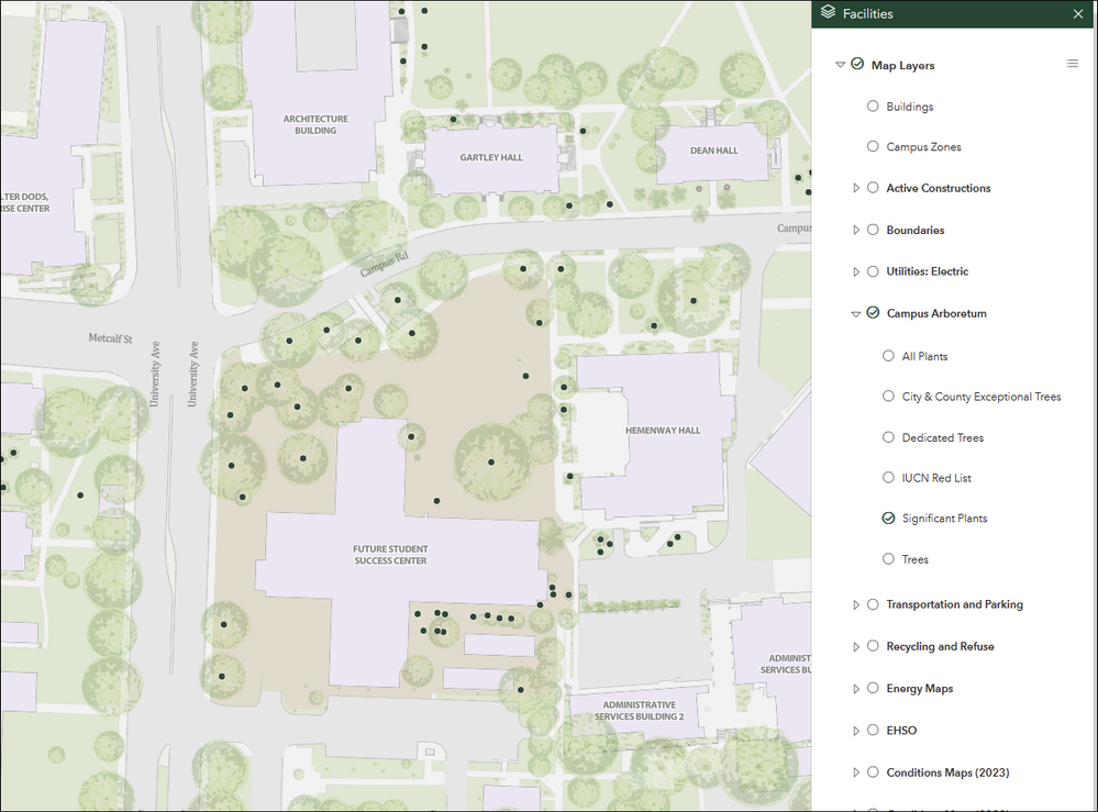

Other applications that include Plants information are our public-facing Interactive Campus Map, as well as an internal Facilities Campus Map. This private viewer gives UH facilities staff the option to see which plants are “Significant”- a detail based on multiple factors which indicates that a specific plant cannot be cut down without additional review. Project managers would use this map to see which plants are within their construction project zones, and if they are in danger of getting cut down or uprooted. If a plant appears to be Significant, the PMs will then contact Campus Arboretum and Landscaping staff before they touch those plants.
"Significant Plants" selector

I like the idea of having tree symbology responsive to canopy area.  The data at my university does not contain this information, and does not have the manpower to send someone out to obtain it.  Did the arboretum data already have this data?  If not, how was it obtained?  I'm thinking of possibly using aerial imagery, but in that case, the canopy would be larger than the actual tree.
JuliusP
Hi Cheryl,
I believe the original data had it before we got involved, but we donʻt
know the methodology.
Around 2020-21, a group on campus working on a LEED certification effort
used the latest campus aerial imagery to estimate tree canopies and we
updated the field with that data. Since we are only using it for visual
purposes, we are happy with estimates.
Aloha,
julius
CherylTrine
Thanks.  I think I'll figure a way to use our aerial imagery, then.  Can't be perfect, anyhow . . . trees grow!
