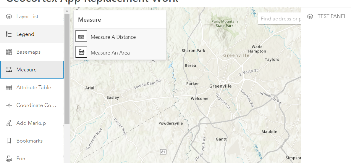

I'm trying to add expandable toolbars on both sides of my map. I've been able to get the toolbars to show up but I'm not able to use the calcite-action buttons to open their respective panel from the second toolbar.
As shown below, both toolbars are present. When I click the calcite action on the left toolbar, the resulting panel displays just fine (Measure, in this example). However, when I click on the calcite action on the right toolbar the panel never displays (test panel, in this example). How can I get the panel to show for the toolbar on the right? I included my condensed code below.

Can you provide the JavaScript code snippet where you add the event listener? My guess is you're only adding the listener to one of the calcite-action-bar elements. You can use querySelectorAll to add an event listener to all of the calcite-action-bar elements.
document
  .querySelectorAll("calcite-action-bar")
  .forEach((element) =>
    element.addEventListener("click", handleActionBarClick)
Or you could add ids to the action bars and use those.
  document.querySelector("#action-bar1"),
  document.querySelector("#action-bar2"),
].forEach((element) => element.addEventListener("click", handleActionBarClick));

Thanks for the quick reply but unfortunately that did not fix the issue. It still isn't unhiding the panel.

I feel so stupid, that is exactly what my problem was! Thanks y'all for such quick responses!
