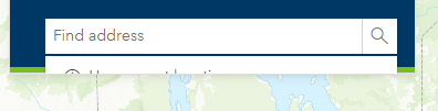

I have an application built with JS 4.25 and Calcite 1.0.3. I'm trying to get an address search in a Calcite panel header but the suggestions get cut off. (The suggestions are cut off when the rest of the panel is visible and has content in it, too.)
Calcite Panel header:

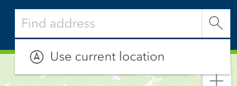

This works fine, though, in a header bar across the whole page in the Calcite Shell:
