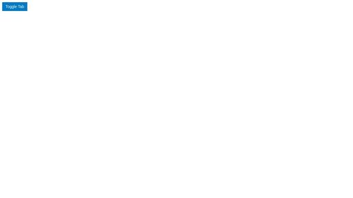

Thanks for the code Paul.  However it seems to only work immediately after it loads.  I am trying to toggle the tabs when the user performs an action.  Try clicking the Toggle button at the top:
https://codepen.io/justingreco/pen/xxqgERZ
paulcpederson
You're totally right, I've opened an issue for this, I think it's just a bug.
https://github.com/Esri/calcite-components/issues/2185
