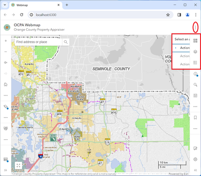

Hi,
Is it possible to add overflow menu on calcite-menu in calcite-navigation?
I like the overflow menu on Action Bar (calcite-action-bar) and I'm wondering if Calcite Component can add similar overflow menu on calcite-menu in calcite-navigation?
Thanks
Forrest

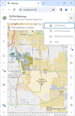

Hi @ForrestLin, you could slot in a Dropdown into the Navigation's "content-end" slot, similar to this example: https://codepen.io/geospatialem/pen/VwNGBae

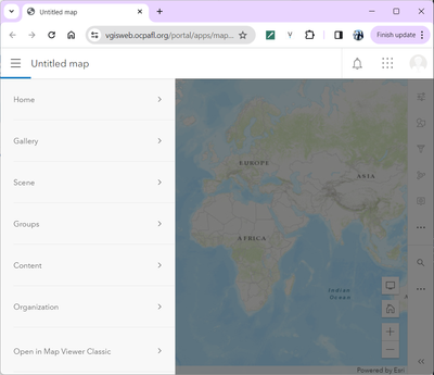

This is what I'm looking for. Is it possible to put the dropdown on the top?
MapView is a good example:
Thanks.

There may be some panel conflicts with the code. Updated the Codepen to reflect one Action Menu with the slotted Dropdown: https://codepen.io/geospatialem/pen/VwNGBae

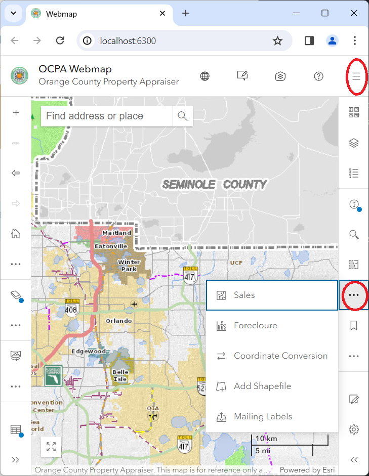

ForrestLin
I fixed the issue by setting z-index.
app.component.html
<calcite-shell>
  <app-header slot="header" />
  <app-panel-start slot="panel-start" />
  <app-panel-end slot="panel-end" />
  <app-panel-bottom slot="panel-bottom" />
  <div id="mapViewNode"></div>
</calcite-shell>
app.component.scss
app-header {
  position: relative;
  z-index: 2;
app-panel-end {
  position: relative;
  z-index: 1;
header.component.scss
@media(max-width:520px) {
  calcite-dropdown{
    display: block;
  calcite-menu{
    display:none;
@media(min-width:520px) {
  calcite-dropdown {
    display: none;
  calcite-menu {
    display:block;
KittyHurley
Great to hear! We have additional z-indexes available on the new token reference page: https://developers.arcgis.com/calcite-design-system/foundations/tokens/reference/#stacking if you'd like to leverage some of our existing values, for instance:
calcite-dropdown {
  z-index: var(--calcite-z-index-dropdown);
