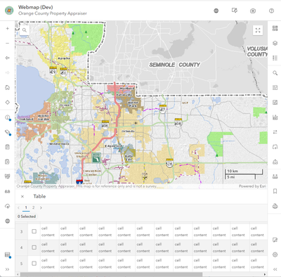

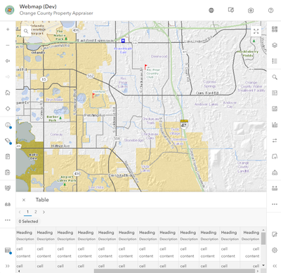

My web app (responsive) used calcite components and has issue with calcite-panel overflow.

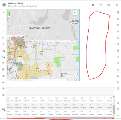

Desktop: The overflow scroll is fine, but there is white space:

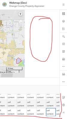

Mobile (iPhone/iPad): There is white space and no overflow scroll:
