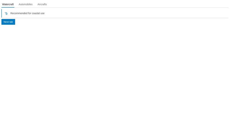

Hopefully this Codepen helps to get you what you're looking for. I believe just setting the `selected` property on the the `calcite-tab-title` that you want to be active using JavaScript should do what you want.

I guess I was way overthinking that one!  Thanks!
