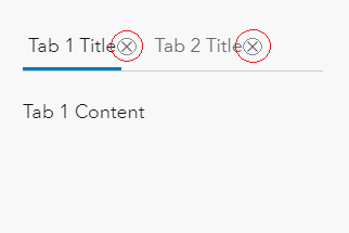

Possible to make calcite-tab dismissible/closable? Like shown in the below screenshot.

Hi @Ranga_Tolapi the above enhancement request was added to the Calcite 1.4.0 release earlier this year on May 25, and is available from 1.4.0 to our current version released earlier today (1.10.0).
Below is an example implementation, which adds the "closable" attribute to the Tab Title component:

Hi @KittyHurley, we would like to show multiple FeatureTable widgets in multiple tabs (calcite-tab) and allow users to dismiss/close the tab. Any plans to include dismissible/closable feature for calcite-tab?
