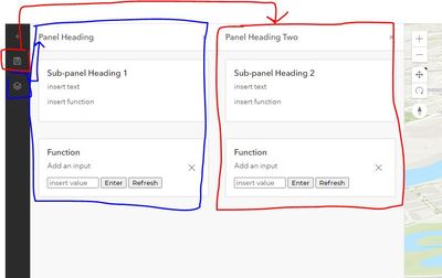

Hi Ben, no worries and thanks for the solution. It works! Also, do you have any idea how to encapsulate shell panels into one single panel when i click the other tabs on the left? Currently mine is resulting with two panels with the action button enabled which is not what i am looking for. thanks 
BenElan
Esri Alum
I'm not sure how you set that up, but if you have two separate panels then you should make sure to collapse one when you open the other.
